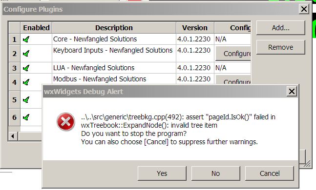

New problem.
Uninstalled all versions of MACH4
Reinstalled from new 2230
On entry into config Modbus plugin, get this message:

There is an orphan node in the modubs settings (inside the profile's Machine.ini).  Choose "no" or "cancel" and try to use the modbug config dialogs to get rid of it or edit the Machine.ini file.
