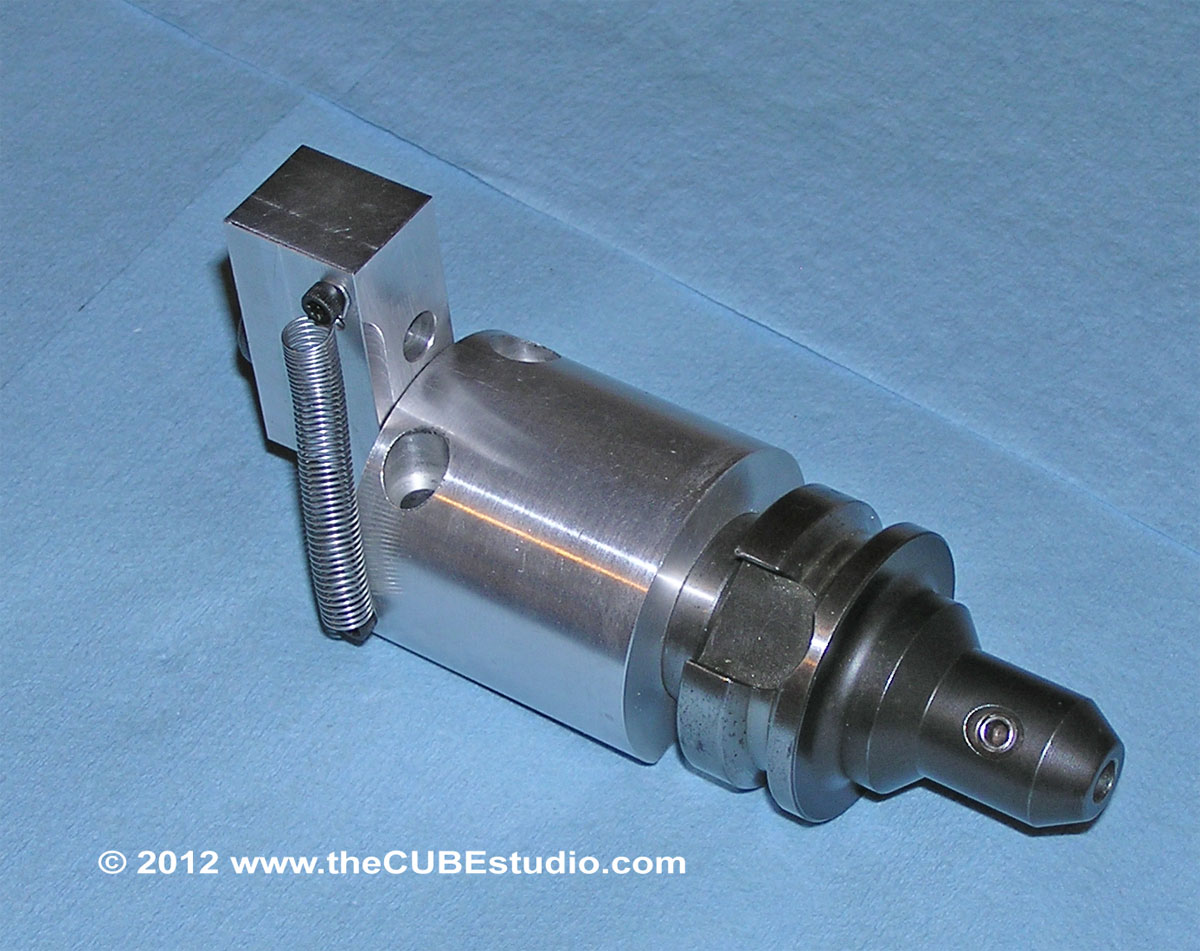

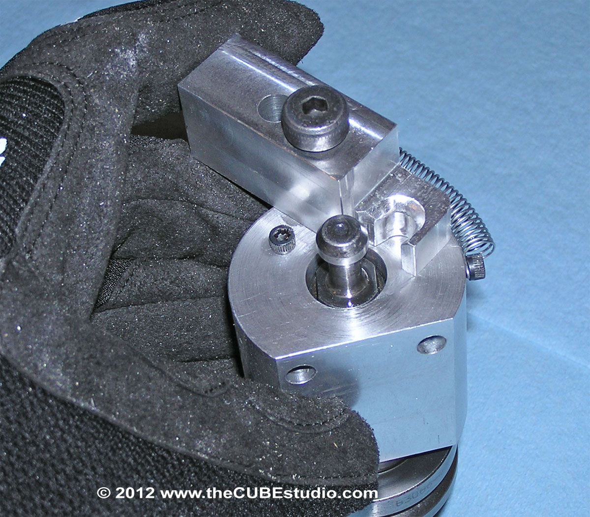

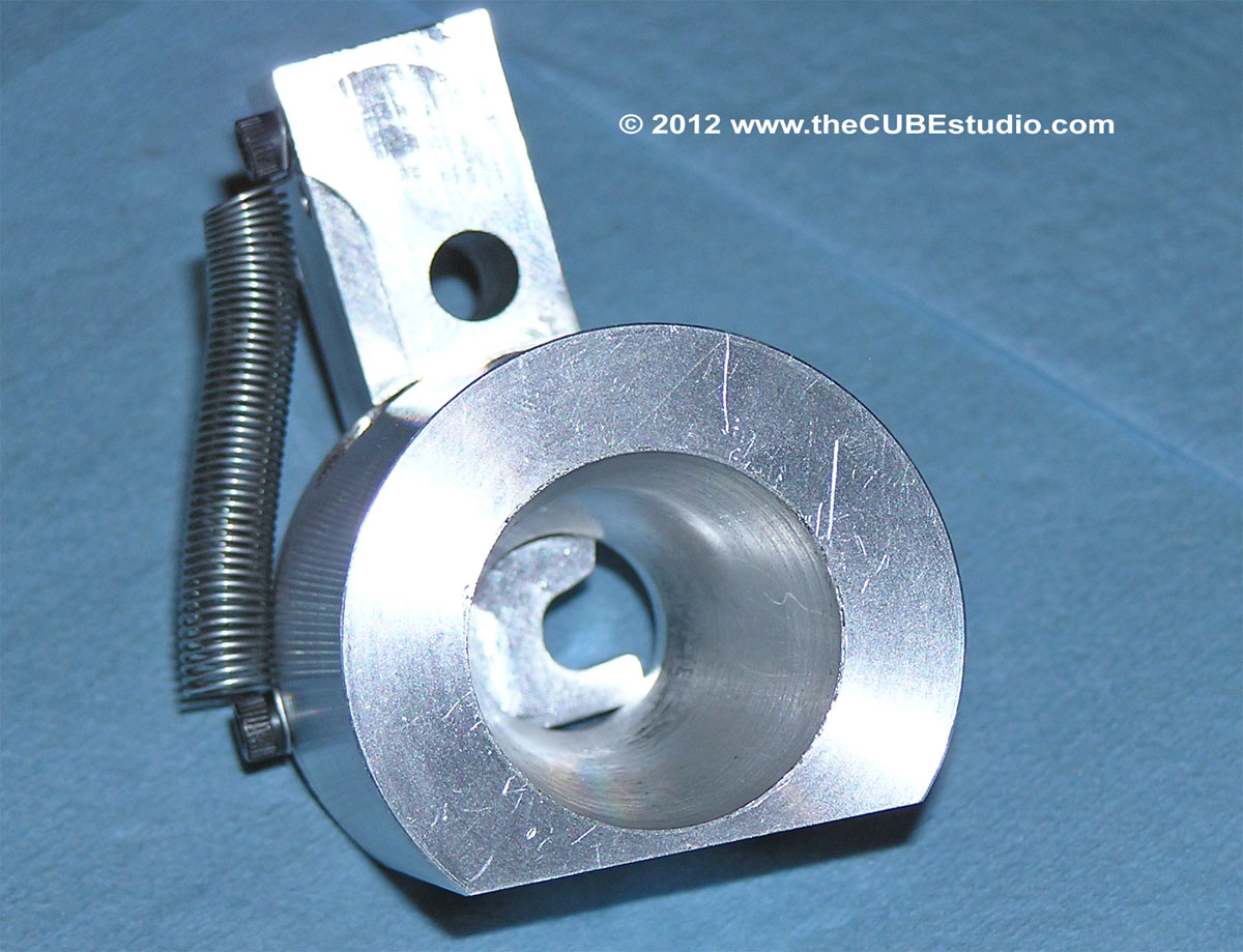

Picture worth thousand words:
This it the first prototype 'pod'. There would be 6 (or more) of these bolted to the outside of the turret wheel or to the chain belt
The body survived the cut, but the lever is being replaced by a modified design to be more 'jam proof' . . most likely the coil spring will be replaced as well. Note that the tool taper is completely covered and protected and that the tool cannot release from the pod without the catch being retracted (by the claw on the arm).
The pod body is a little complex, but the entire part; OD turn, flat one side, drill and counterbore two 1/4" mounting holes, center drill, 3/4" drill thru center, taper bore center, drill and tap latch pivot mounting hole, can be done with a single setup and a single program on my InTurn™ 4th axis . .   provided I had a working ATC . . . Catch-22.
