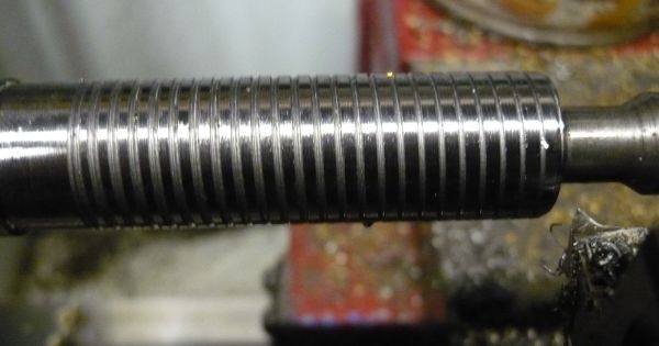

  Actually, what Stev is getting on a 4 inch or so thread, when cut shallow, and can easily be seen, is the crests at the middle all look pretty much the same, but the first 4 or 5 crests shows a narrowing of the crest, then it stabilizes to a set width to just about the end of the thread. I was wondering if others are seeing the first 4 or 5 crests showing a narrowing.. As the enclosed shows..
Art

« Reply #195 on: April 07, 2009, 06:57:56 PM »
I suspect proper prep was done, Stev and John are pretty good machinists. Im not sure why their threads dont look like some
of the ones here, but John does report his Aluminum threads are good, its the steel ones that seem to vary in pitch as it goes.
Ill run soem diags witha special driver with them to see if turnign off spindle speed correction shows anythign interesting..
Thx for your input..
art

First off a little background for the machine.
It's brand spank new and has been designed as a CNC from day one.
Spindle is driven by a 500 watt 3 phase brushless servo with encoder feedback to the driver board, this then drives thru a 3:1 timing belt reduction so it's at max torque at 800 rpm.
True speed at a requested 800 rpm is 800 to 804 and steady.
Ballscrews fitted with no discernable backlash, no compound, everything tight.
I'm running the same tests over and over which is a 2mm pitch thread 80 mm long, short threads don't show an error like the long ones and I'm positive that you need to cut long threads and use a tap or known screw as a pitch gauge because a thread gauge fits along the thread due to the fact it only covers about 4 or 5 pitches.
This is what I'm getting for the first three cuts
Unlike Steve who was getting a narrow land at the start and end and OK in the middle I always get a good thread at the start and an increased pitch at the end causing the land to become very narrow.
At the end of 80mm I'm about 1/2 a pitch or 1mm out.
Art has picked up on aluminium threads being OK but they were shorter ones for a job.
tomorrow, well later today as it's 1:30 am here I'll cut a long alloy thread with the same driver I have on the machine now.
Then I'll swap to the driver Art has sent and redo the threads in alloy and steel, scratch cuts at first.
John s.
