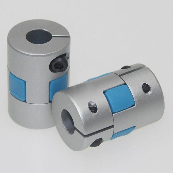

« Reply #198 on: April 08, 2018, 06:26:50 PM »
all my ballscrews are direct drive. I use those el-cheapo aluminum couplers with a spiral slot in them. They flex a bit
and result in 'lost motion' which is not desirable but what has happened is on the odd occassion where I've crashed
the coupler shears off rather than wrecking the gearbox/stepper/ballscrew. Something like a mechanical fuse.
Craig
'I enjoy sex at 73.....I live at 71 so its not too far to walk.'
Re: Only X-axis motor is working
« Reply #199 on: April 08, 2018, 07:26:27 PM »
Craig
I was thinking of using those but maybe something a little beefier than the cheap Chinese ones. I know there are a few styles of the cheap ones though so who knows.
I don't need to buy a new ballscrew every time I make a programming mistake.
Maybe a coupler system like this will work
