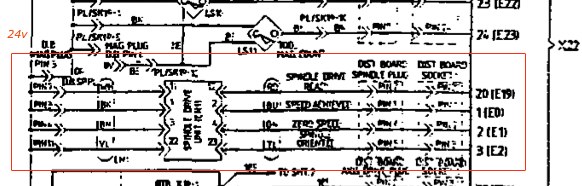

Hi Johann,
Would you share the Fanuc connector pinout?

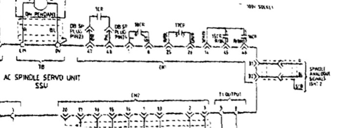

Dan,
Fanuc type is A06B-6055-H103 with a A20B-1001-0120 orient board.
Connections of CN1 are,
1,2 Speed achieved
3,4 Zero speed
7,8 Ready
11,12 Alarm
22,23 Orient achieved
25,26 Orient
31,32 Analog speed 31=0V 32=0-10V
14,45,46 Spindle start and direction 14=common, 45=FWD, 46=REV
47,48 E-Stop

Thanks  a lot Johann!
Why are the output pins in pairs? Are they relays or what?
They are contacts. With the BP the signals run from 24v. The inputs are NO or NC over a relay.

So how do you use the Orient pins, for example, do you have to short pins 25 and 26 to command Orient to the VFD?
And what happens, for example, when speed is achieved? Does an internal relay closes pins 1 and 2?
Yes when you connect 25 and 26 the spindle will position itself and when the position is reached the orient achieved pins 22 and 23 are closed. when you open 25-26 the orient procedure is stopped and 22-23 will open again. While 25-26 is closed the motor is powered and keeps the spindle locked in position.

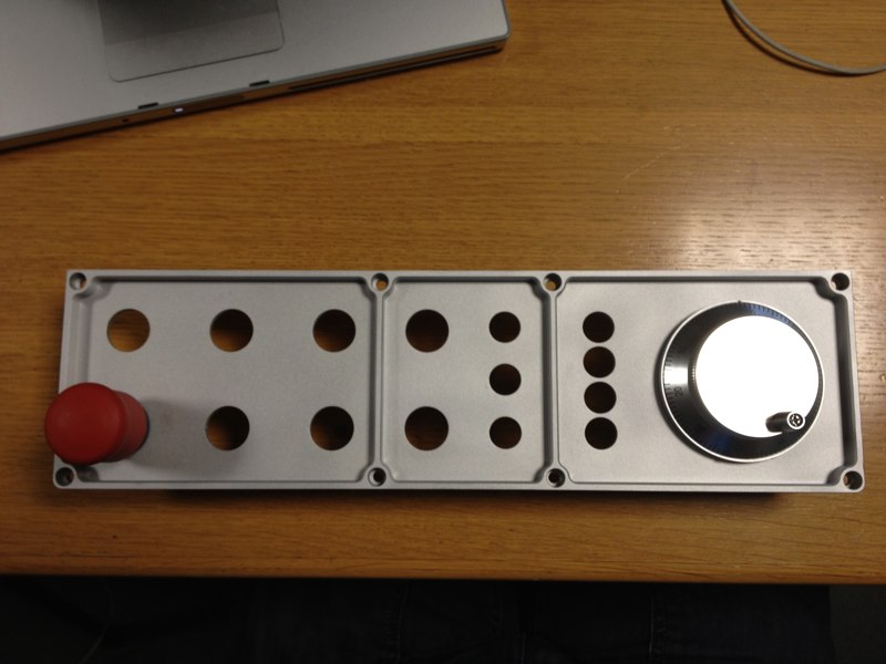

This weekends effort,
Machined and sand(glass)blasted the operator panel,
Hope to receive the buttons this week.

Panel looks great, blasting has given it an excellent look, may have to invest/make  one as that is impressive :)
