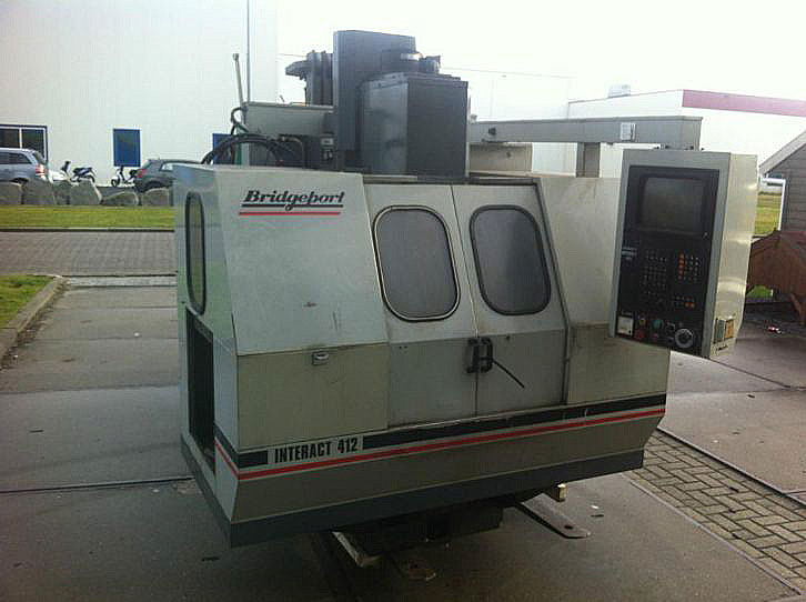

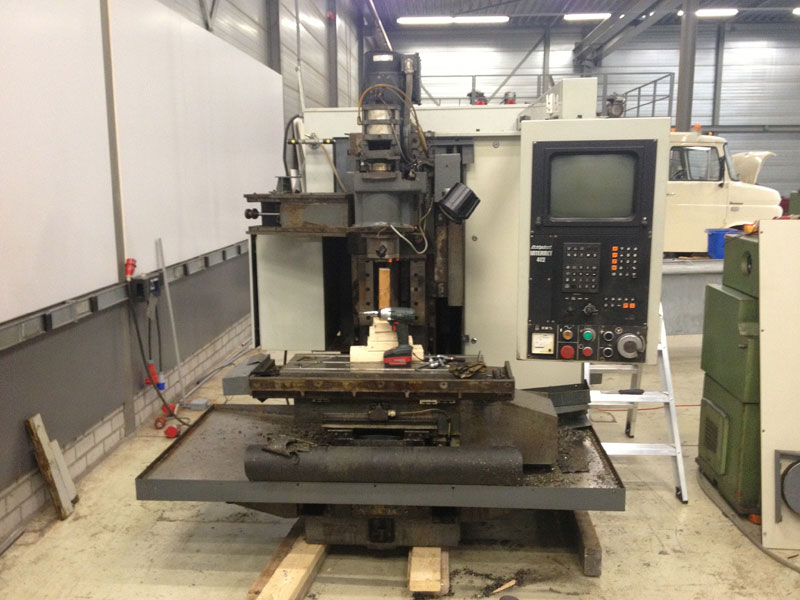

Bought an old BPi412 a while ago.
Machine was supposed to have lost it's parameters. Price was accordingly and some tools came with the machine.

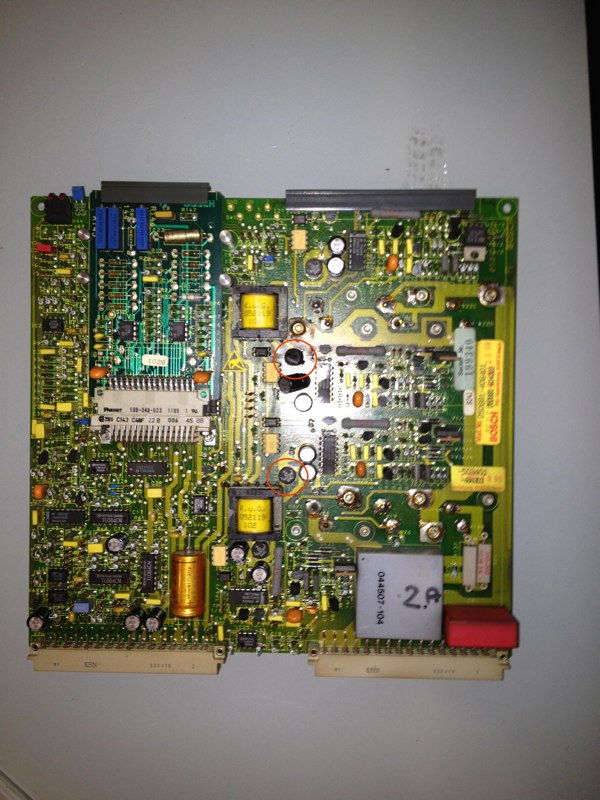

After receiving the machine it turned out the parameters were still there but the Bosch servo amp had a problem.
An attempt to repair the amp didn't work out so I decided to replace the servo's.

While waiting for the Bosch amp repair I partially took the machine apart.
This to clean up the huge mess inside the machine and also to paint the inside of the machine white to make it appear a bit less depressing, a bit more light inside. I want to keep the outside as old looking as it is.

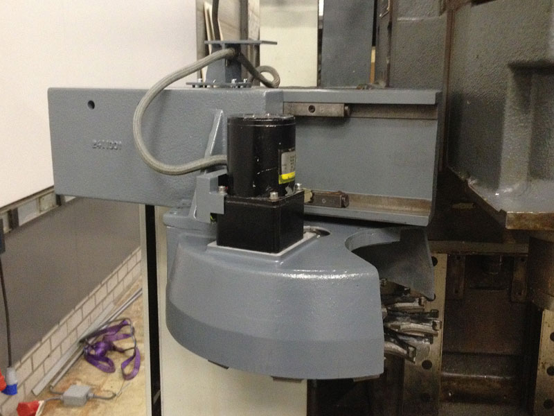

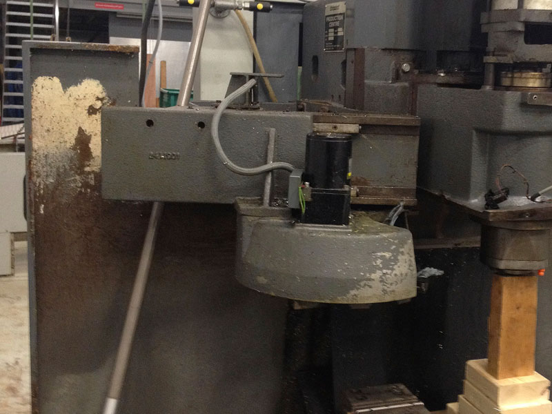

Also repaired the ATC,
Before,
After,
Welded a crack in the turret mount and replaced the bearings. Cleaned everything and added some paint and grease.

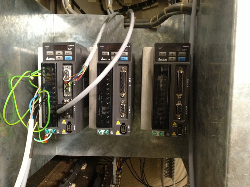

After receiving a Delta servo motor I made new mounting plates for the motors and ordered new pulleys and belts,
Removed the Bosch cabinet from the machine and made a new placeholder for the Delta drives,

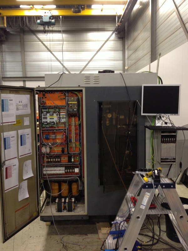

About three weeks ago I ordered a CSMIO straight from CS-Labs in Poland. Also ordered an MPG unit with it. Removed most of the electrical parts from the machine. Managed to find a very bad quality diagram of the machine and discovered that I had removed to much from the cabinet..  ;D
After 5 days the CSMIO arrived and I started rewiring the cabinet. The Fanuc Spindle was a bit of a headache but eventually I managed to trace all the pins. Got the Fanuc working with the CSMIO. Spindle Orientation is also functional. Reused the ATC motor and used the original wiring with it. Basically managed to get all the OEM parts working. Only tested one drive so far because I'm still waiting for cables. Drive appears to work well. Needs some fine tuning when everything is in place.
Not being an electrical guy I think the cabinet looks pretty neat so far,

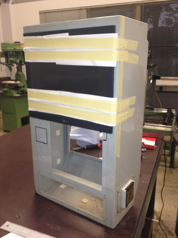

Have the machine running now from the computer screen. Still need to make the operator panel. Order a couple of buttons and a hand wheel. Started mounting a monitor to the panel,
Not sure about the layout of the controls yet...

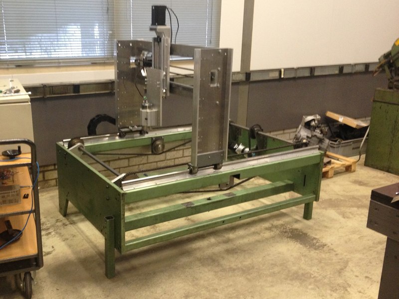

This and that I already had an IP-M made me decide to go for the S. With the M I only did some testing with a couple of steppers and started on a scrap build router using hybrid stepper drives but is a slow going project. I assumed Mach would use the controller in a similar way. Never knew the A will keep the position at all time.
Very far from finished though..
For the Z-axis I use the drive's output for the brake function. This because the drive knows when the motor is powered. The assumption here is that it will account for the latency. The only remark I have with this is that it appears the brake is operated more frequent compared to when operated by an external control.
Index has been set up as recommended by CSLabs.
