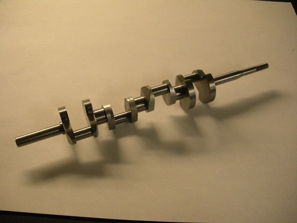

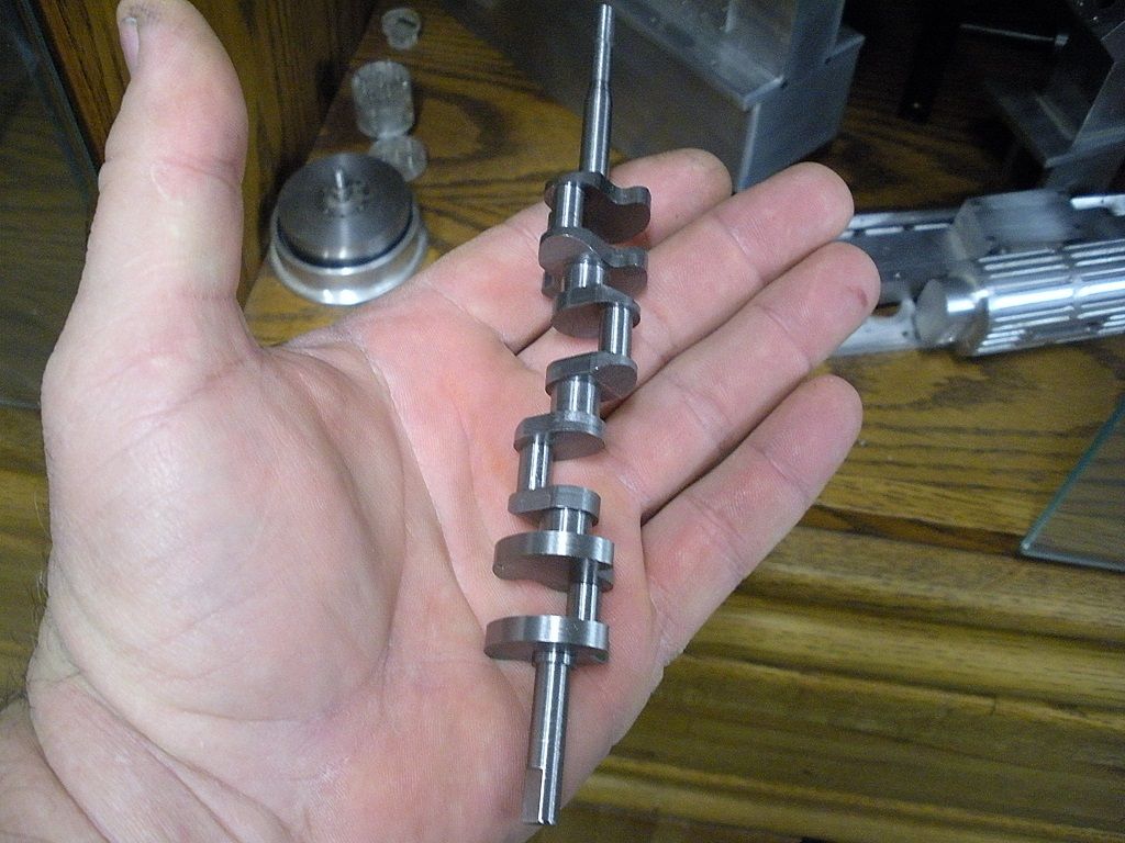

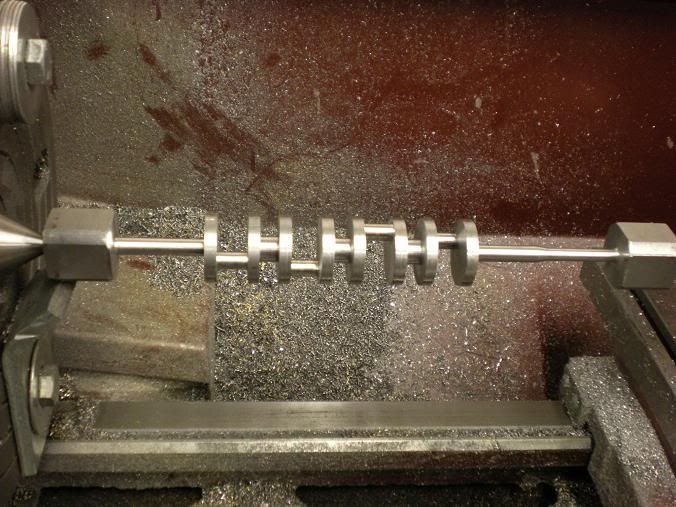

TOTALLY PEGGING THE COOL METER!!!
Man, how in the world do you turn a crank on a Lathe (just small time lathe hobby guy here).
Scott
Re: 1/5th Scale V8 Blown
« Reply #34 on: February 02, 2014, 09:19:14 PM »
Scott
Drill all 5 centers in both ends. Then I rough out the ends and centers. Mill down the crank arms and then finish them. Then the last thing I do is finish all the mains last in the same setup.
The rest was done in the mill.

Beautiful work Steve.
I had been puzzling about the setup for machining the offset cranks but now you mention the 5 centres it all seems so obvious.  ;)
