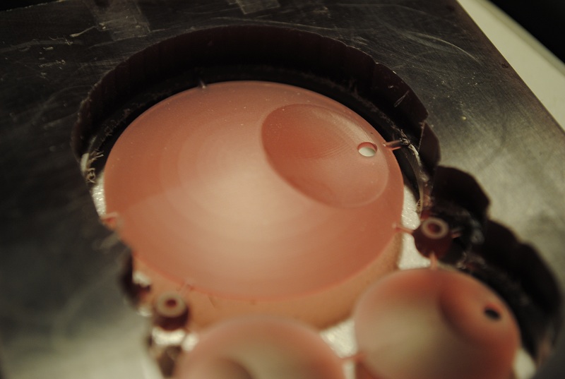

mirror of a post on 3dcad forum about when arcfitting will bite your ass...
well.. blow me down.. I learned something today.. arc fitting can sometimes work against you!
on low gradual surfaces the arc fitted code resulted in a VERY stripey cut, and i was waaaaaaaay dissapointed.. I had to recut anyhow as the wax came out to thin, on the next cut i forgot to ARC fit my code and the resultant cut was infinitely better.. it did show some stl facetting.. very minor tho in comparison to the distinct striping from the arcfitted code.
SAME STEPOVER, SAME TOOL, SAME STRATEGY, SAME SPEED.. only difference was the arcfitting.
ARCFITTED PATH
NON ARCFITTED PATH
Uploading a video clip to youtube now.

Hey Chris,
Could you explain this a little more please. I am baffled.
It looks like the top photo has the toolpath running horizontal wheras the other photos look like the toolpath is vertical to the piece.
Surely if the stepover was the same then all phots would show the lines, wouldn't they ?.
« Reply #236 on: March 11, 2010, 02:34:18 PM »
the first cut was arcfitted, and the resulting arc was drawn over a perfectly spherical shape.. IE: one arc from left to right.. the bottom path was left as a sequence of XZ,XZ,XZ,XZ etc etc then one Y movement at each end. I have never had this happen before and i think the reason is exactly that the arc travels the complete distance of the piece.. the part was pathed at 0.005 path to model tolerance but the arc fitting happened at 0.01 tolerance arc to path, so some averaging of the resulting arc occurred.
note in top pic the line is perfectly smooth over X, no stl faccetting to be observed. perfect RC.
bottom one plenty evidence of facceting but no striping.
