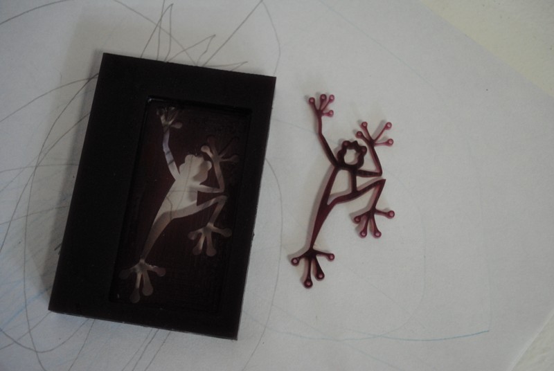

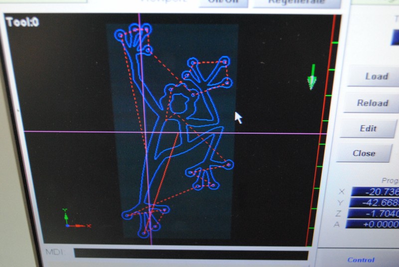

Total cutting time 9.40... including the surfacing (1200mm/min surface, 600mm/min profiling)
oh its a broach pin... diamonds in the toes and eyes... sigh....

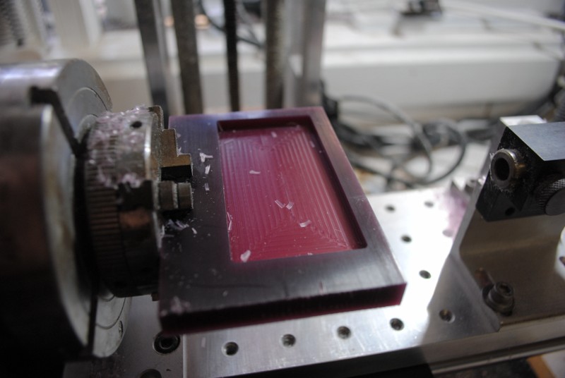

« Reply #226 on: March 04, 2010, 04:55:01 AM »
So you finish a cut, super fine job, and admire your almost non existent supports... (as an idea of scale the hole in the settings is 5.2mm and the surrounding prongs are only 0.3mm each)

THEN.. you turn the wax around and find this!
Metal shavings from my lathe got into the remelt!!!  (hoping its AL)
NOT GOOD! Cutters no likey metal metal.. dey go breaky breaky.. I got lucky this time..
time to inspect the rest of my remelt stock..
« Reply #227 on: March 04, 2010, 12:04:02 PM »
Close call there Chris.
Reminds me of an a**hole TIG welder where I once worked.
There were aluminum weldments that needed some of the fillet welds machined.
This guy would bury little chunks of the carbide electrode in the fillets  just to pi** off the machinists.
He didn't last long.

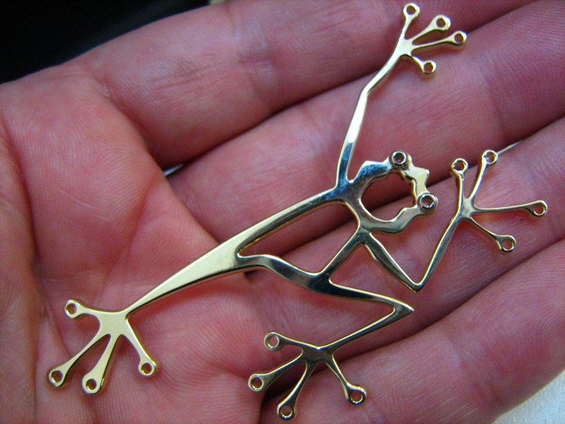

« Reply #228 on: March 04, 2010, 01:43:10 PM »
GecFrog went directly from the setter to the client (overdue), I never saw it finished either :(
