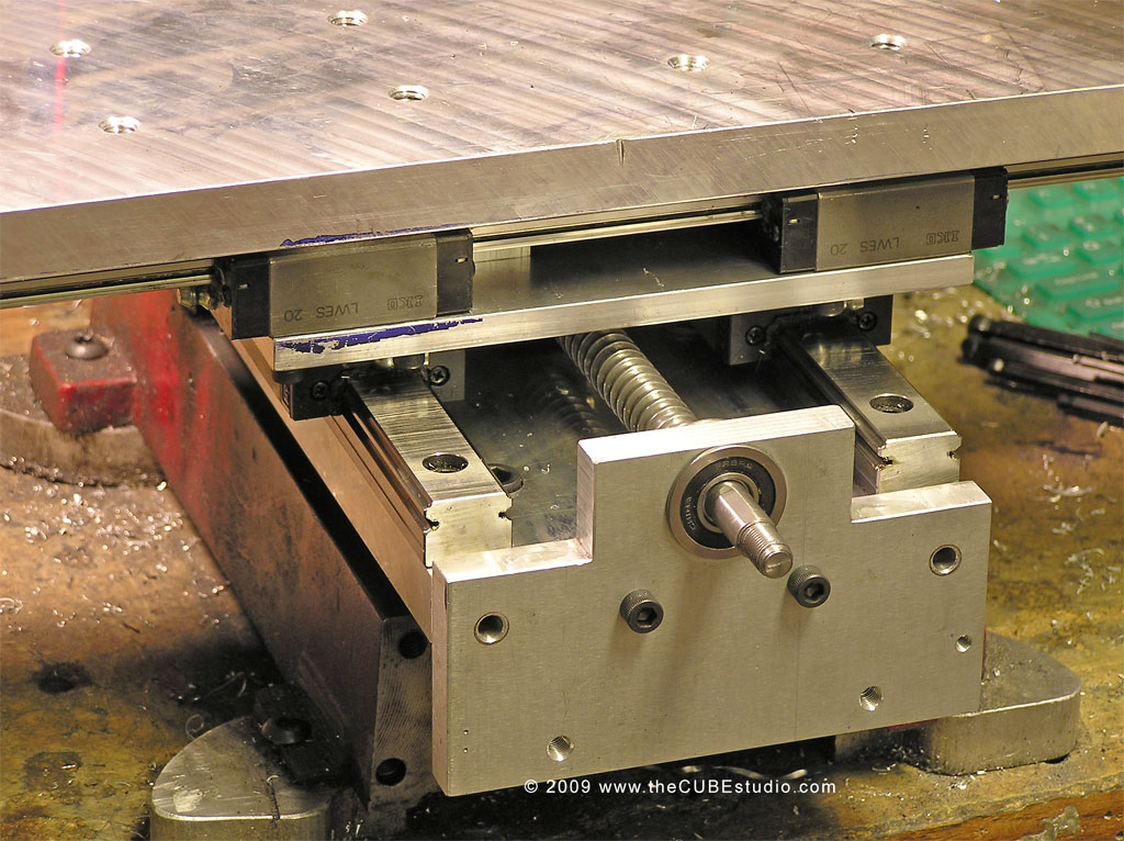

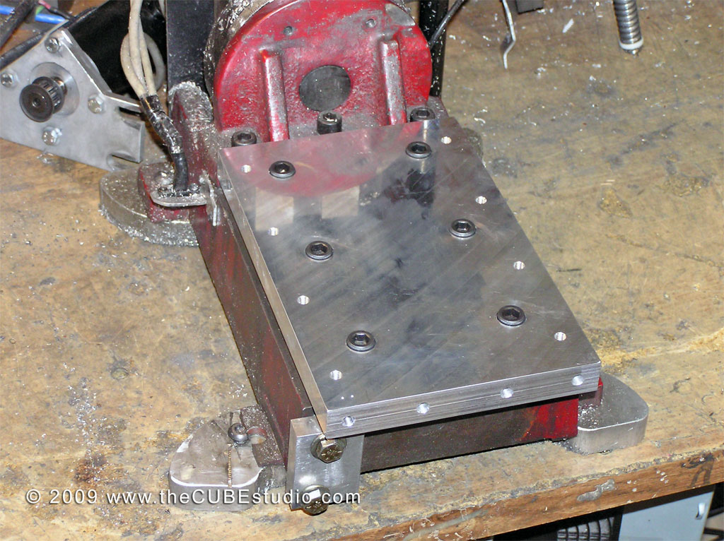

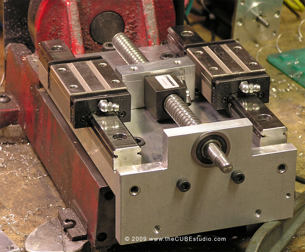

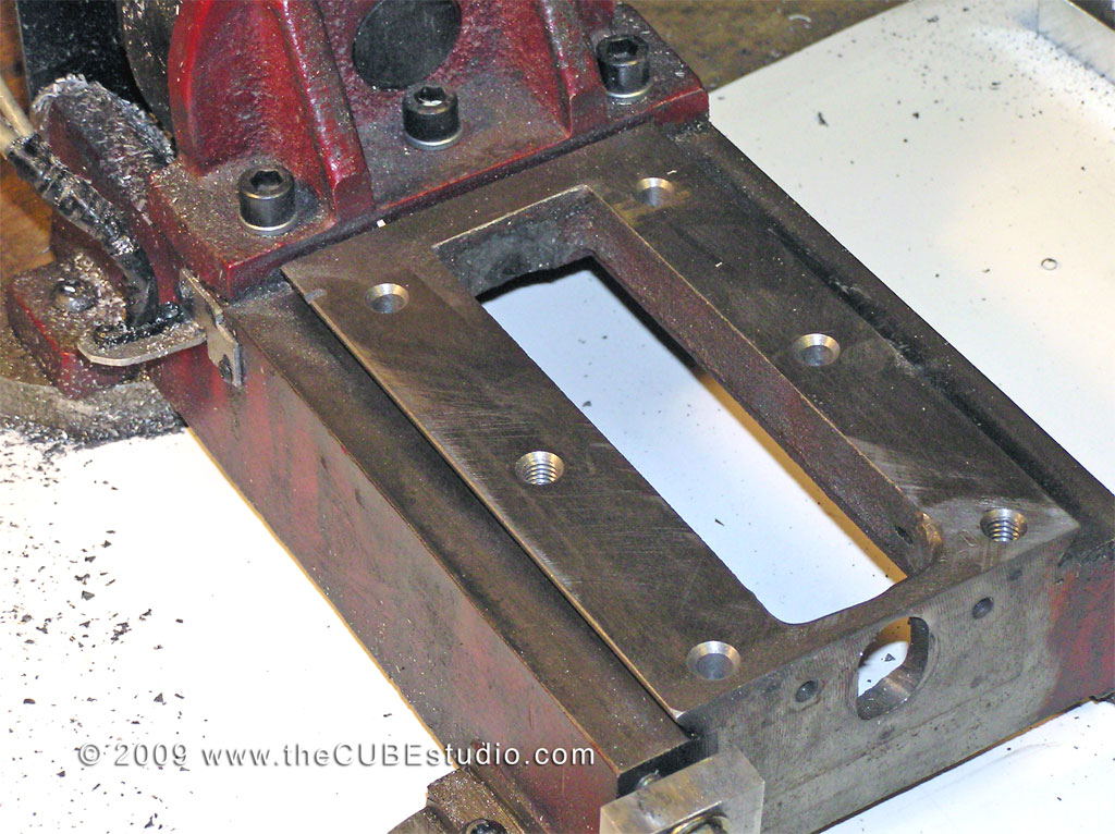

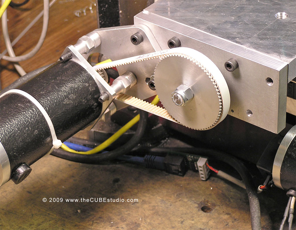

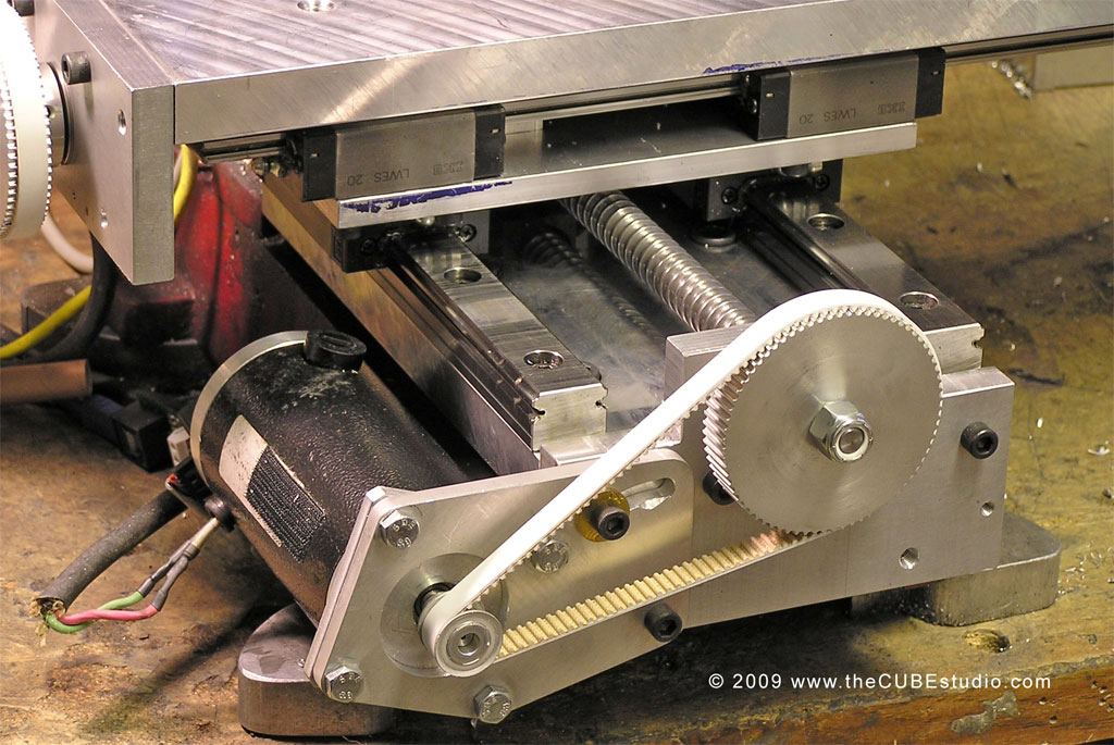

Here are some details of my new XY table. I designed this for a client. There will be 4 of them to be put on new X3 machines for a specific purpose. This was probably the most fun thing I've done with the CNC to date. The Thompson ball screws are temporary because the post office lost the ground lead screws that I bought for the project. They finally did arrive and the grinding video shows the end prep. I sold the original CNC converted X2 table as a complete setup with all the CNC stuff included, includeing all three axis photointerruptors (home switches).
The new screws are pretty amazing. I have the table set now for 300IPM rapids. You can see this in the video showing PCB routing.

Those hose fittings are being used as stand offs?
I want to die in my sleep like my grandfather, not like the passengers in the car! :-)
« Reply #76 on: November 09, 2009, 11:58:15 AM »
YEP!!   Waste not want not . . LOL!  Those are test pieces from my 4th axis project . . .  I have <ahem> quite a few   :-[
Speaking of recycling, I just listed these Thompson ball screws in the 'Bargain Basment'. Somebody may as well get use out of them. They are brand new and I have no further need for them.
« Reply #77 on: November 10, 2009, 03:26:00 PM »
Nice job Simpson!
Looks like you lost a fair amount of travel on your Z with these slides ;)
Are the mounting plates and the bearing plate made of aluminum??? Or is just the photo?
Daniel
« Reply #78 on: November 10, 2009, 04:33:52 PM »
Nice job Simpson!
Daniel
Well, lets find out. It is 4.4" from the dovetail flat (on the X2 base) to the top of the table. I sold the original table and saddle, so if someone with an X2 can measure, we'll have the answer. I had over 12" of Z travel, so I wasn't particularly concerned about it. The new base plate is 3/4" and doesn't need to be for an X2 (the table is designed for an X3), so an other .25" could be eeked out of there on an X2.
Everything is aluminum ground jig plate. The solid aluminum table weights only 0.4lbs less then the original cast iron table.
I will be building an entire new machine frame also from aluminum and making a complete new head from aluminum. The total weight of both head castings on the X2 is 16lbs. The new aluminum head will weight 24.6lbs  . . both figures do not include the spindle, bearings, motor, drive parts, etc.
The stock X2 column weights 17.5lbs. The new column will be 20lbs. X2 base casting weighs 17.25lbs. New base will weigh 19.5lbs
