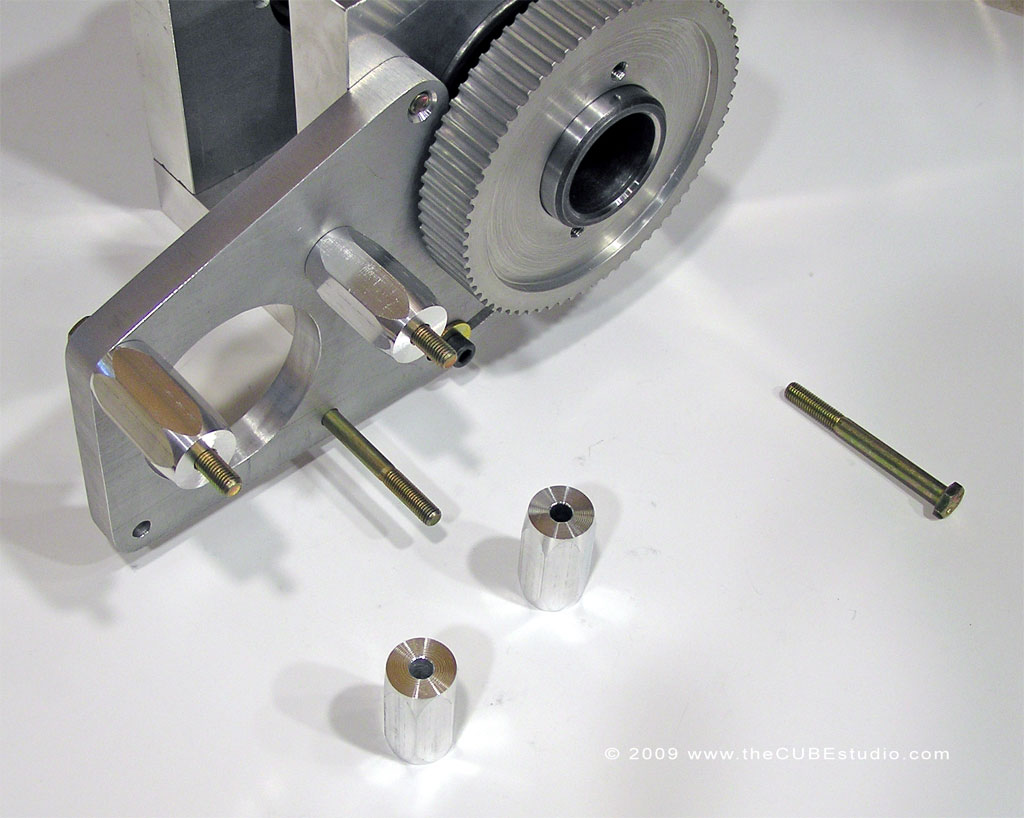

These are the new drive parts. Older trapezoid tooth belt is gone, replaced by newer GT2 type. Quieter and can handle a lot more power. This time rather than making a pulley from scratch, I took an off-the-shelf pulley and modified it by cutting out the center and mounting it to a stock clamping collar which is comes already drilled for mounting a pulley. Between the stock pulley and clamp collar, I saved several hours over starting from scratch. Collar is bored for a slip fit on the spindle . . no  more threads. Preload will be accomplished differently. More on that later:
Spindle is out of a PhaseII brand 5C spin indexer. Still an import, but about three times as expensive as the normal junk and it is much better quality. Roughness in center portion of the spindle is from me reducing the dia slightly in that area with a coarse zirconia flap wheel to ease bearing press and reduce the interference fit on the rear bearing for preload purposes. Front bearing (next to shoulder will have full press fit. I will probably be making my own spindle, but for now this is easier.

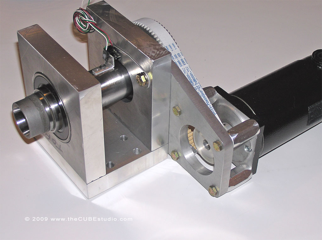

Fabrication complete. Still needs a guard on the belt.
I am planning to build a tailstock for it by modifying another spin indexer.
I'll post a link to a video once I get it hooked up and cutting metal. Should be an improvement over the first proto, especially in accuracy due to the better spindle.

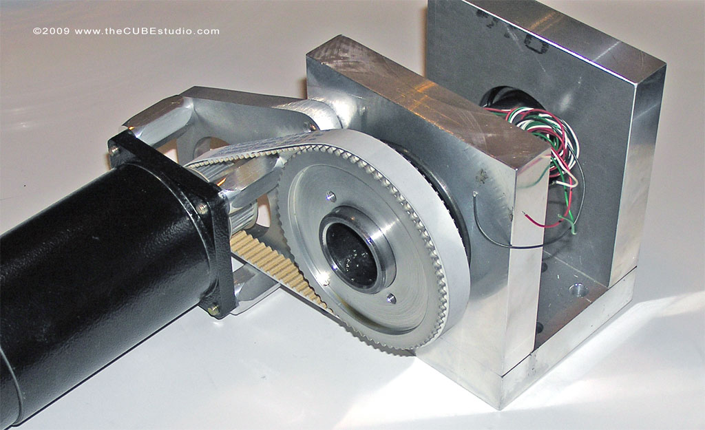

Detail of the motor mounting parts:
Final Assembled unit front and rear:

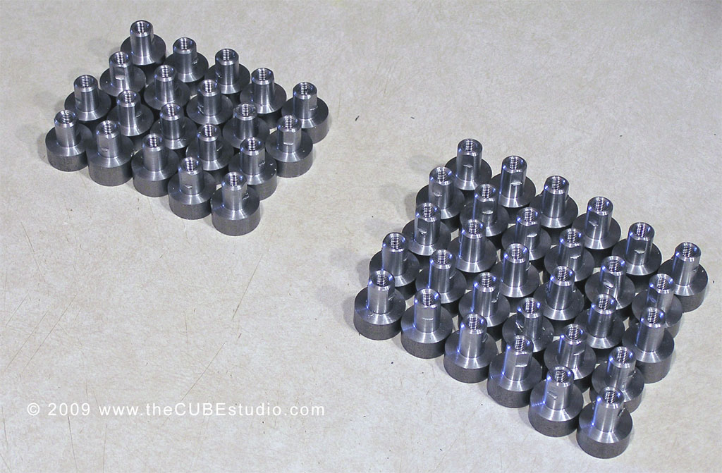

4th axis is now producing the little steel part for which it was created. Hard tapping is at the end of the video. Light cuts are due to lack or rigidity in the X2 table. Next project will solve that issue for X2 and X3.
This has been a fun project with a successful conclusion. Thanks to those who helped out with knowledge and ideas. Here is the final video:
http://www.youtube.com/watch?v=p0kIWpylrqk
First run 30 front and 20 rear :
