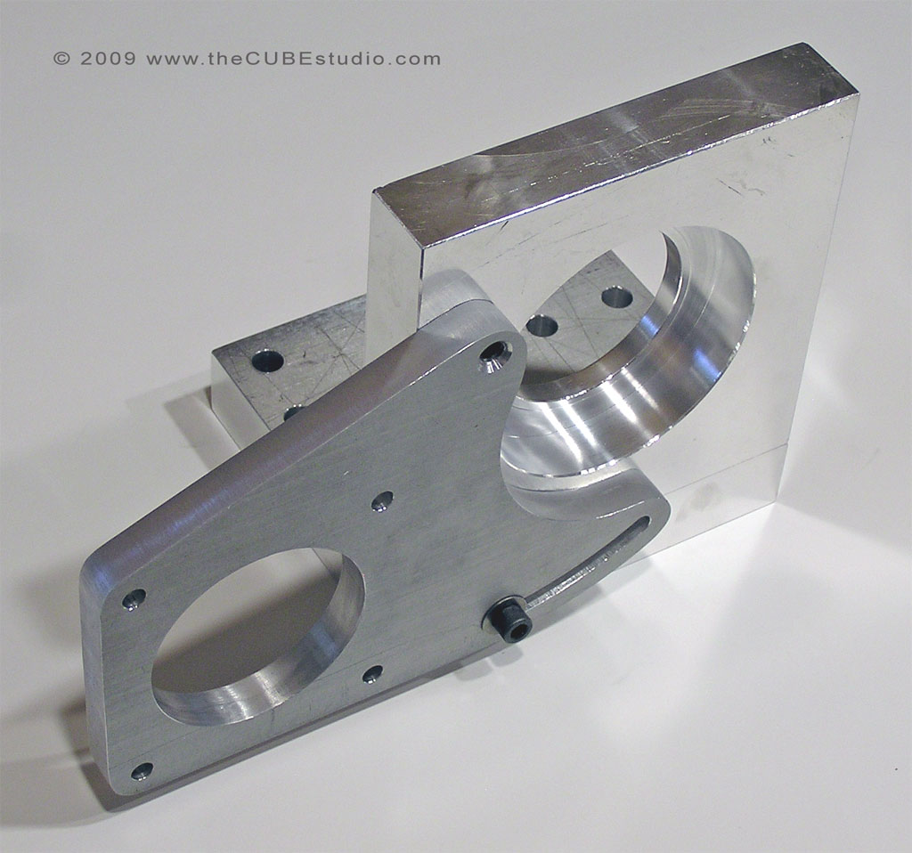

UPDATE: started new prototype. Again not doing anything exotic so anyone wanting to follow along should be able to duplicate these results and build yourself a nice addition to your mill. Material is 1" thick 6061 plate. Motor plate was planned as 3/8" thick. but is 1/2" due to 'scrap on hand' material sourcing.  :-[
This is the new frame  . . essentially the same as the first proto, just bigger to allow for larger chuck or workpiece. Also better fit to larger table on my planned next mill. What is very different is the motor mount. Expensive idler is gone and belt tension is now accomplished by rotating the entire mount. The big hole in the mount is not necessary. I put that in to ease belt and pulley changing if I want to experiment with different ratios. Currently 2.5:1 which is a compromise from previous 4th axis which had both 2:1 and 3:1 ratios.
