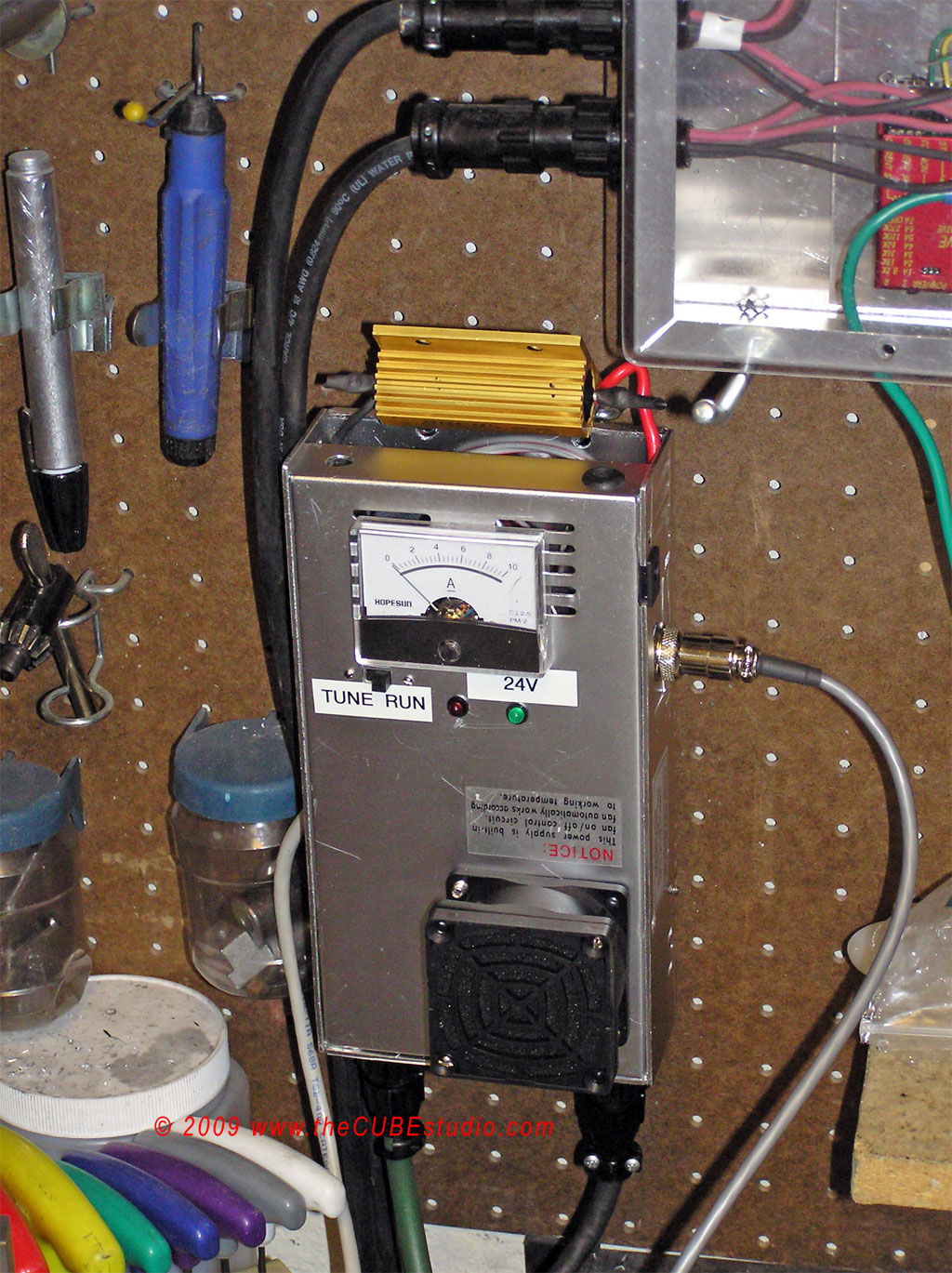

QUESTION (for anyone):
I have a  1 ohm 100W power resistor in series with the motor per Rutex spec.  It is in a finned aluminum housing and it gets friggin HOT!  I have no accurate way to measure how hot this thing gets, but you definitely cannot touch it. How hot do these things run normally?

This thing is a lot hotter than 70C so I better do something about that.
The resistor was mounted on the outside of the aluminum box that houses the 4th axis servo drive, but it was heating up the entire box!
I have some huge old finned heat sinks from Pentium 3 CPUs. Methinks perhaps I'll bolt the resistor to one of those and mount it remotely away from the control box . .  where I won't burn the crap out of myself by accidentally touching it  :'(
 . . .  -or- . . . I could mount it to the mill itself behind the Z axis post.  That should be able to absorb a days worth of heat and would not result in having longer wire runs to the motor.

Below is my solution to the resistor heat issue, FWIW. The fan at the bottom blows into the box and cools the Rutex drive inside and the air exits the top and flows past the resistor, which is bolted to the box along its rear edge. It stays cool enough to touch most of the time.
Final score on the servo drive. With the Gecko I could get a .015 cut at about 700 RPM max spindle speed. With the Rutex drive, I am getting an .080 cut at 1,100 RPM max spindle speed. There seems to be power available to exceed this, but the maching rigidity is now the limiting factor. Needless to say, I am well pleased with that result  ;D
