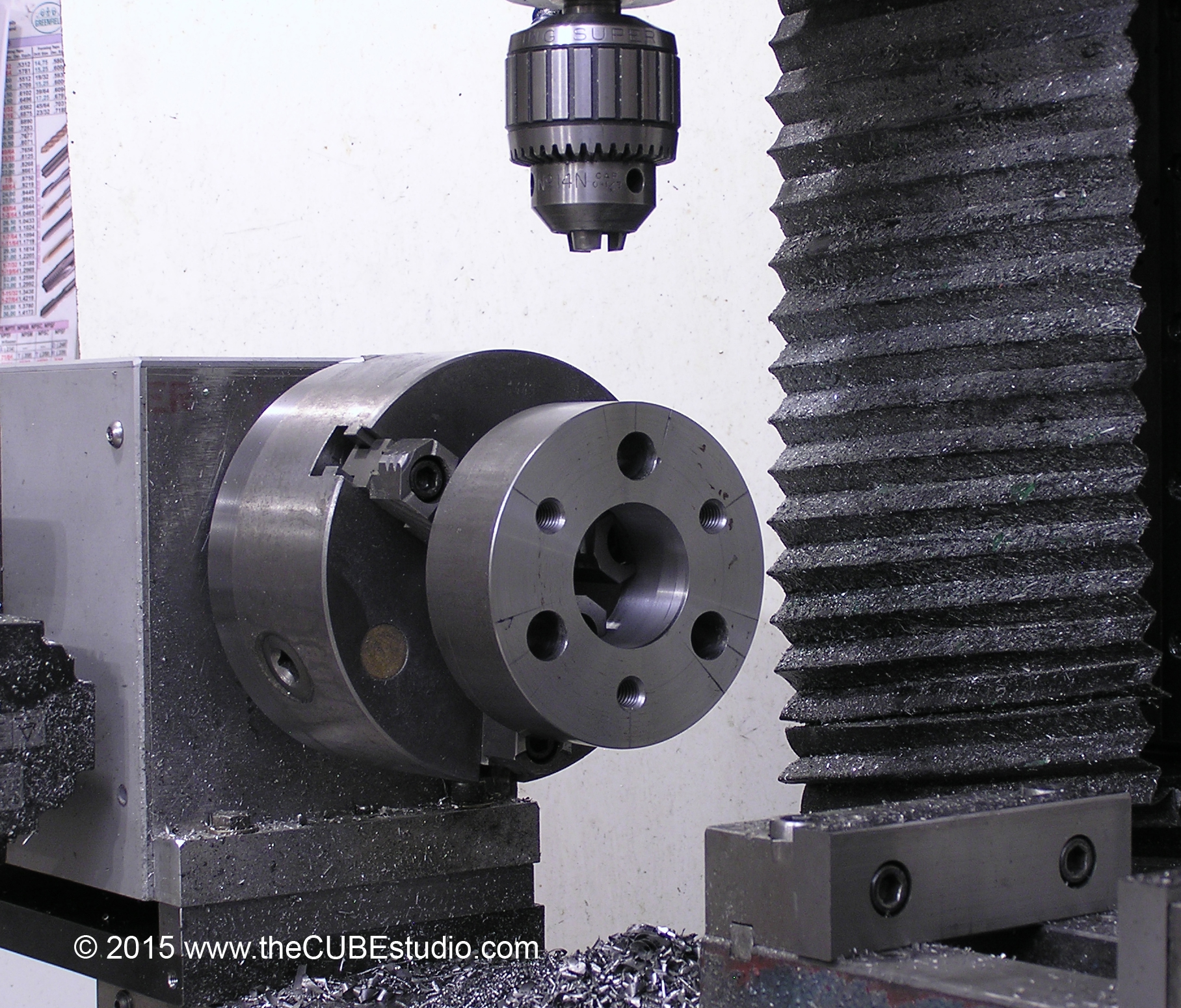

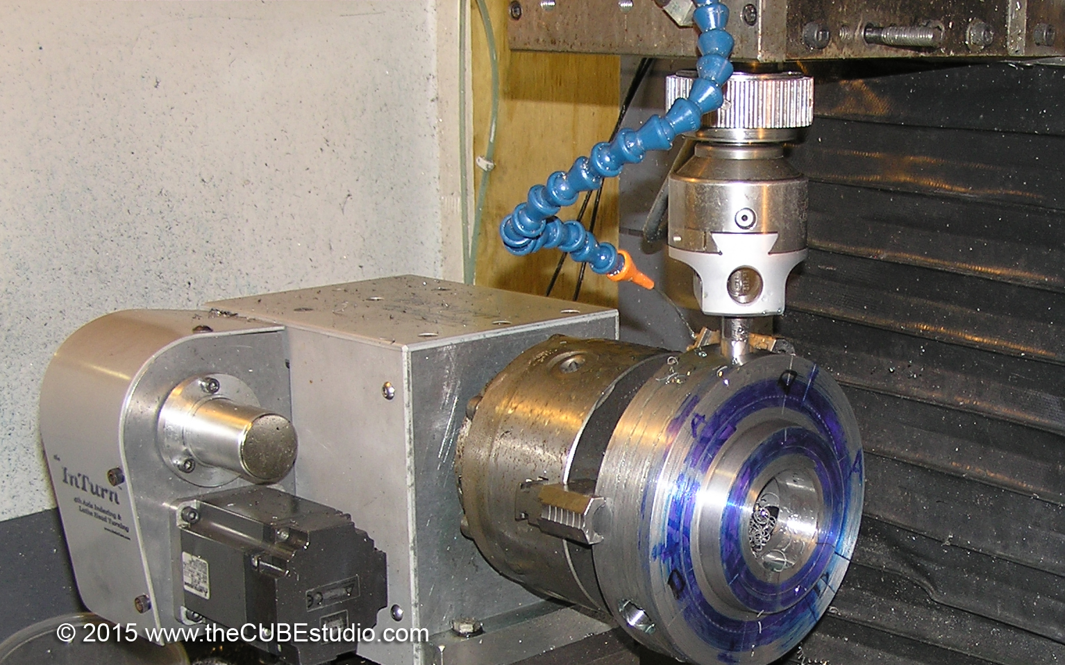

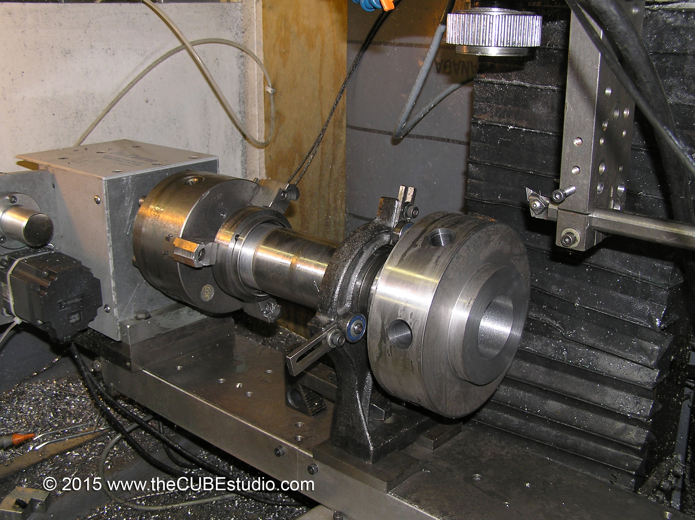

HIYA Steve, (OT) do yo have a picture of your 4th doing a radial type drill opertaion? I am working to finish a new WIZARD for 4th axis drilling and am in need of a good picture to go on the page.
A static picture (setup) would be fine if it just showed a round object in the chuck and a drill in the spindle just above the object. I will trade you a copy of the wizard for the picture (;-) I have a new TURN version for drilling as well for lathes to do offset face drilling. Do you have a picture of that as well?
« Reply #284 on: January 26, 2015, 03:28:56 PM »
There are videos posted on both of these operations, but I should also have some quality pix around here, so let me dig a bit and I'll get you fixed up.
« Reply #285 on: January 26, 2015, 05:41:35 PM »
Terry,
I found a few very hi res photos of radial setups. As soon a sI get them edited and copyright notice on them, I will upload them to my ftp and put a link here for download (big files).
No pix of the horizontal, just video, but I have the original HD footage and can lift a decent photo. Here is the vid. Give me the number off the timeline of the images that you want and I'll pull a couple of pix off of it for you
https://www.youtube.com/watch?v=Dd_M6Li_OrA
