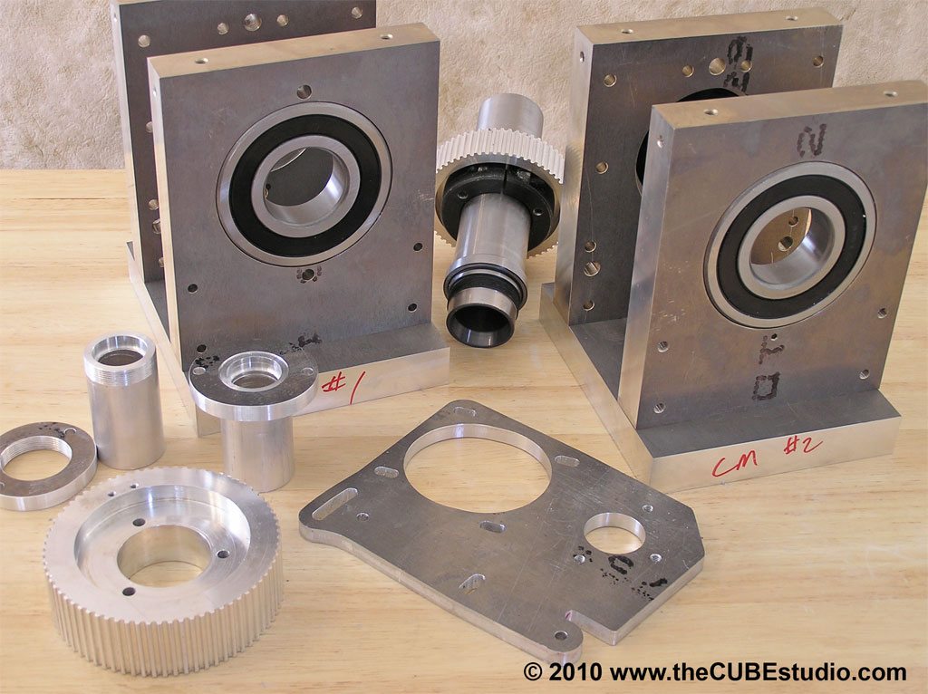

5C tailstock mock up:
Little better shot of the part:

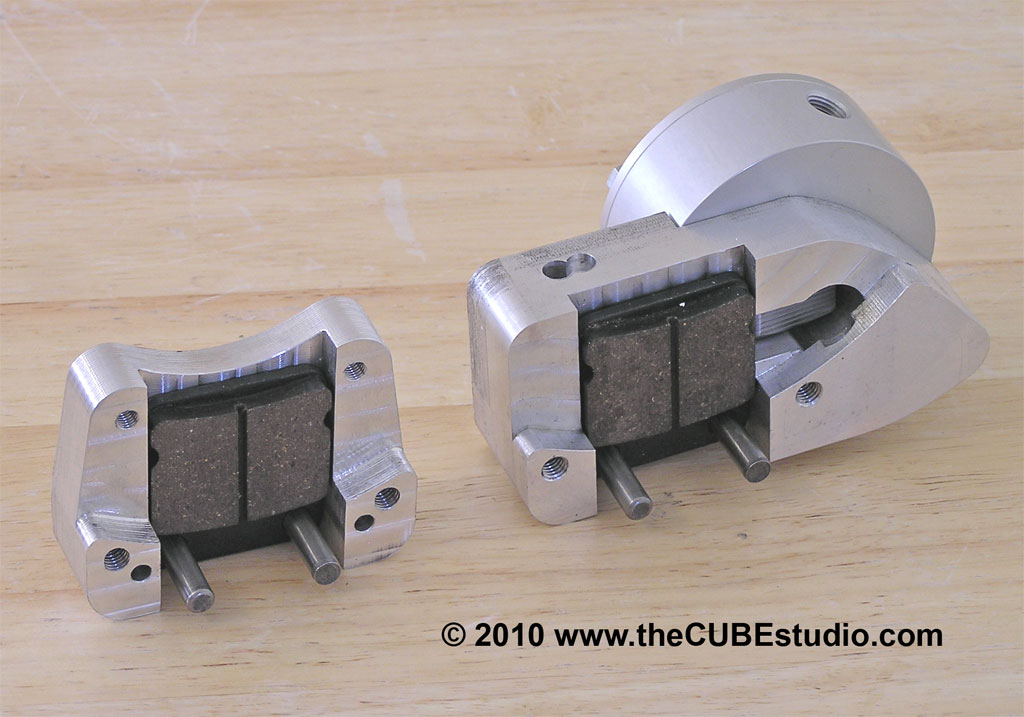

Brand new integrated pneumatic caliper. Latest articulated verison on the right:

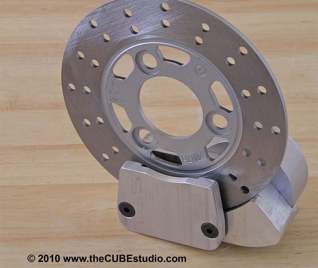

Lock and disc:
New belt drive setup:
FInally just some frames and various components:
I'll update this thread with the new tailstock and trunnion table progress and development continues on those projects.

That being said, every machine designer works to a spec and design criteria. Pretty much all things are doable, particularly in the realm of prototypes, but nobody will purchase a 4 million dollar mouse trap so cost is usually one of the criteria. Because of the pneumatic disk caliper and custom spindle drive pulley, this 4th axis is not an easy DIY project.
Note in the photo that there is no real estate available internally for additional components for an auto shifter mechanism. The spindle lock is a critical need and cannot be eliminated. In fact, the current model is even more crammed as it has a larger air cylinder which required the frame to be expanded slightly. Automatic shifting IS doable, but all features must be evaluated based on cost/benefit and there is also no 'room' in the pricing to add such a feature and remain affordable to the target market. Some challenges with your proposed scheme will be retaining a hollow 5C spindle, very high rotating mass and perhaps there would be consequences to having large electro magnets in close proximity to CNC equipment. I think syncronizers might be a reasonable alternative if automatic shifting is a requirement in your application. Note that on my 4th axis, you do not loosen the motor or the idler. Both are mounted on a moveable plate which is how the belts are changed/adjusted and the same belt is used for both high and low ranges.

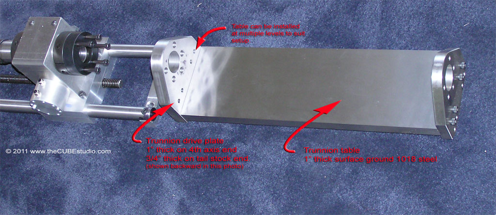

Videos showing the new tailstock and trunnion table:
Tail stock is finally completed. It has the original planned features as well as some new features. The ball bearing supported hollow 5C spindle is probably the largest difference between this tails stock and any other. The version shown in the video is the first prototype whick has now been sold and the latest version is similar, but the leadscrew redundancy has been removed and a new adjustable drag and spindle lock have been added. Some new videos of that version will be added soon.

And finally the first tests of the trunnion table:
http://www.youtube.com/watch?v=itJqDwl7X2o

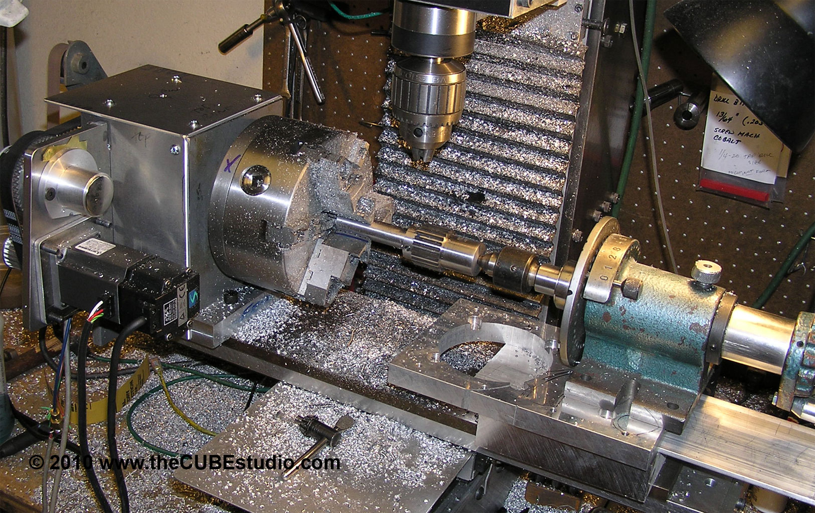

Use 4th axis for sharpening
http://www.youtube.com/watch?v=Y3PIdnNwsAg

I have been thinking of using a 4th axis as a tool grinder for some time now. Nice to see you actually doing it and getting good results. Gives good motivation.

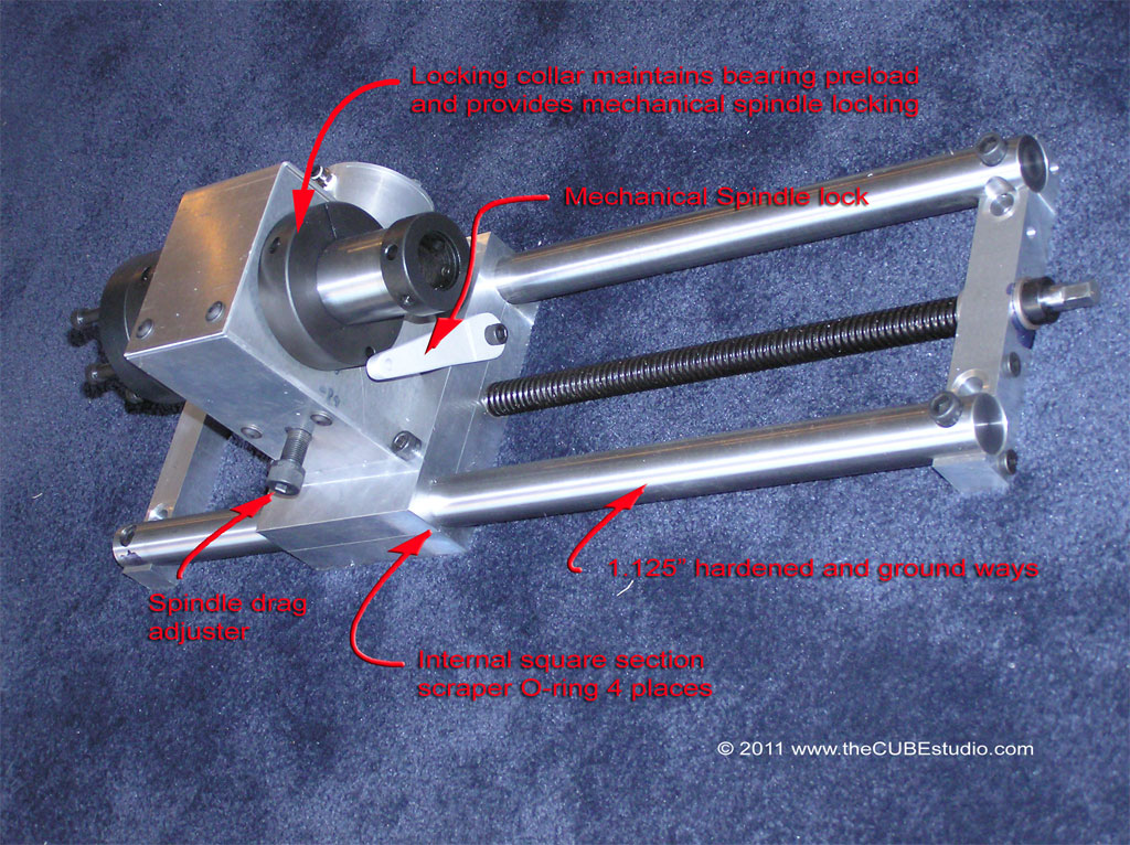

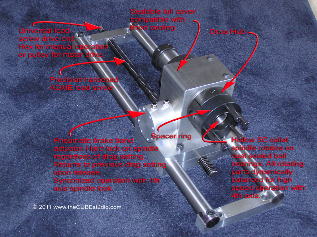

Some pics of the latest tail stock. Redesigned to eliminate positioning redundancy and to add spindle grag/lock mechanism.

It looks like the tail stock is about 5" wide?  This could work on an X2.

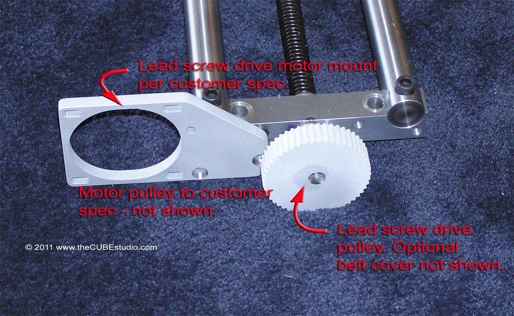

To use this on a mini mill you really do not need the lock or break.  But you would need to figure out a belt and motor.  I have also though of using a X2 spindle box and remove the gears then mount a pulley on the back with a belt and motor.  Problem is that I do not have the equipment to mod the parts.
http://littlemachineshop.com/products/product_view.php?ProductID=1906&category=-269978449
Issue with any of the existing Phase II style tables that are retro fitted with a stepper motor is the backlash is difficult to control if you put any real hours on them.
« Reply #228 on: December 13, 2011, 01:24:12 PM »
The tailstock frame is only 4" wide. In the case of using the tail stock as a 'mini' 4th axis, there would be no need for the rails and therefor, the base could be 4" wide and bolted down from the front and back like the 4th axis base.
I would not consider using a mill spindle because you are going to have R8 or MT which are not good choices for a 4th axis. These are designed to hold cutting tools, not workpieces. 5C is better because you can pass stock thru it and also there are an amazing array of collets available for 5C, including square and hex, as well as 5C mounted chucks.
There is a fundamental difference between a motorized rotary table and my 4th axis in that a rotary table is strictly for indexing. It cannot rotate any where near fats enough to do turning. With a 5C spindle sitting on ballbearings and a tooth belt drive, you have indexing and also turning in the same device.
A paradox inherent in this chameleon is that to get speed useable for turning, you need a servo motor and servo motors, while vastly more powerful and faster than steppers, do not hold as well. that is the reason for the spindle lock.
