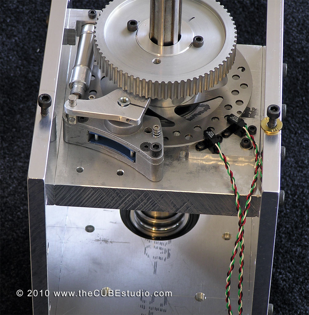

« Reply #106 on: January 26, 2010, 08:19:38 AM »
It is a disk brake. The disk is .062" 2024 aluminum and is intended only for holding and not for stopping. The servo motor provides deceleration. The mechanical disk caliper is from a 'pocket bike'.
The lock was 'added on' and not part of the original design, so it could be better integrated, but other than having the disk extend past the frame (which requires an elaborate belt guard), everything worked out satisfactorily.
The servo drive is a 'Dugong' model from CNCdrive and they are modifying the firmware for me so that the drive's max amps can be set back a fixed amount under software control. This will coordinated with the lock event. The purpose of this is to prevent the motor from overheating if it disagrees with the location of the lock event. Keeping the amps below the motor's continuous rating will prevent possible overheating and damage to the motor.

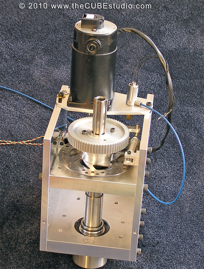

« Reply #107 on: January 26, 2010, 09:12:15 AM »
Here are a couple pics of the new mill showing the spindle lock. In this case, I may want to use the brake for stopping the spindle, so it is a thicker steel part.
Next photo shows nearly fial assembly. Belt guards nor installed yet, etc.

Thanks for the pictures.
I can see the brake clearly now.
You mention the problem of the servo dithering while at rest. If was only going to use the 4th axis as an indexer would I be better using a stepper motor instead?

You could use a stepper but also with a servo you could have a macro so that when you apply the brake you disable the drive a split second later, that would solve any tripping problems.
